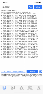

Is this normal? I am testing 1m away from the router. Testing from iPhone11 in 5ghz band.
By the way, i already did the reset recommended for new routers.
Thank you!

No, of course not normal.
Try testing from 3M instead (you're much too close right now).
After the reset (what method did you use), did you use a saved backup config file? What settings did you change past defaults? What features did you enable?

I've tested from 5m away too and I've got the same latency spikes.
I actually used the steps you provided (New M&M 2020). I have been reading a lot from SNB for a month now :)
As mentioned, I've set up my router from scratch without any config file backup. As for the features, I haven't enabled anything as I wanted to test the router out of the box without any changes in the router's configuration.

If you're testing 'out of the box', that could be the issue too. :)
All the defaults are not best practice, out of the box.

Okay, that's good to know. I will be testing with additional features later on and will see if I will still have these spikes.
In the meantime, since you're using AX86U, do you experience any spikes from your end?

Ive tested with aiprotection, traffic analyzer woth no QOS enabled but i still have the spikes in latency.
Also, ive tested with an AC wifi device and i got spikes as well. I thought earlier that i only have these spikes in ax devices but now it seems that it doesnt matter what device im testing from.
