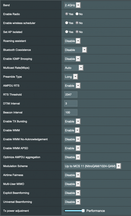

You must have a setting in the 2.4GHz control panel professional settings that is interfering with your devices. Check that you have universal beamforming, airtime fairness and Roaming assistant set to disable.
Thank you very much for your suggestions. I had a look in the professional tab and universal beamforming and explicit beamforming were enabled so I disabled them. The rest are already disabled.
With those changes, my Kindle seems to connect easier and it's showing 2 wifi bars, marginally better than before when it couldn't see the SSID or it'd connect with 1 bar and drop out.
With the PS4, it also seems to see the SSID easier and is able to obtain an IP address. But it's reporting my internet connection as failed and I can't proceed with the connection test.
Edit: Did another PS4 test and it doesn't see my SSID nor get an IP. I don't understand why the 2.4ghz is so weak. I can see my neighbors' SSIDs and I can't see mine in the same room.
Is there anything else I should look out for? Here's my professional tab for 2.4ghz:

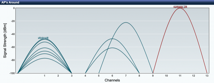

I ran the AC86U's site survey and it looks like the 2.4ghz signal strength is strong:
For me they all over -60dbm are strong. But no reason for ch.11 left alone to work well, only problem is the very strong ch7 slightly overlapping. Whoever uses it should change to 6!
Try on ch. 1.
Common 1-6-11 scheme is not that important anymore. Today's routers deal better with interference and use channels more efficiently. Auto channel selection on newer routers often jumps on channels 2-3-4 and 8-9-10 and actually pushes more data than on usually recommended 1-6-11. I personally never had any success with 1-6-11. In my area the best throughput channels on 2.4GHz band are 4 and 8. I only use 2.4GHz for my Guest Network and channel 8 is the only one providing about 30-50Mbps to clients. Channel 1 is dead, cant do any better than 2Mbps.

I noticed you newer acknowledged trying to change the channel.. Did you try it?
And I do mean ALL of them.
Hi, I've tried that. I've also done a site survey using the router's built-in tool. The odd thing is it shows the signal strength as very strong. Here's a screen cap from earlier:
screen-shot-2019-09-19-at-8-15-24-pm-png.19363
