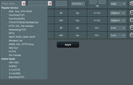

ahhh I didn't realise.
There seems no way at first glance of giving voip the very highest priority/guaranteed bandwidth, but Ive not searched
very deeply on here or elsewhere yet. It needs like 100% priority and say 2% of the bandwidth to be guaranteed.
I thought it'd be a specific packet type. voip isn't available on the drop-down:
You have to set it manually by port range or prioritize specific device. Traditional QoS settings are limited.
