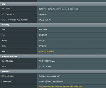

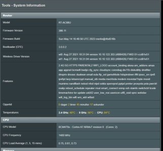

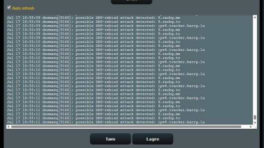

I have the same problem with my RT-AC88U, I lose connection on ALL devices, except for LAN devices, they stay connected.
It happens more often than every 2 hours.
I have done all the steps mentioned in the first post, alongside I have also flashed the original AC firmware, I didn't have any issue with that, but I love asuswrt, but using it, I lose connection on both 2.4 GHz and 5 GHz, quite often.
Sometimes 2.4 GHz refuses connections from my device after a while.
If I restart the router, then everything seems to be fine for a while.
I am using LAN 1-4 (5-8 is empty)
It seems like i might be DNS attacked hm.
I have all 13-20 devices connected to both 2.4 GHz and 5 GHz at all times.
I also have an RT-AC66U as a repeater after this, and that device never had any issues like this.
Any suggestions?
@RMerlin
