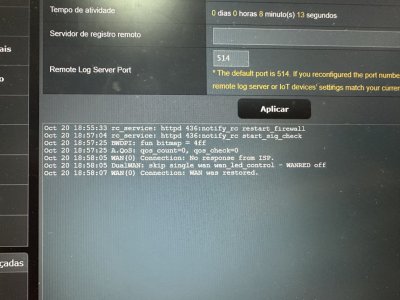

I’m problem in router RT-AC88U, wan port disconnected constant, The problem is not in the provider, because I've already done tests on the outside and the behavior did not happen the same.
Model: RT-AC88U
Replace the ethernet cable between the modem and your router.
I changed the cable for a cat 6, but I still get the same message, it seems to me to be some problem with FW or the wan port of the router itself, interesting that before this error did not occur.
What is Dual WAN used for in your setup?
Does this WAN connection go down in single WAN configuration? Dual WAN is quite buggy in Asuswrt.
I haven't tried using it yet, but using the second link on lan 4 this error did not occur, the worst part is that the connection keeps dropping.
Below is an excerpt from the error log that occurs

Oct 29 21:34:24 WAN(0) Connection: No response from ISP.
Oct 29 21:34:24 DualWAN: skip single wan wan_led_control - WANRED off
Oct 29 21:34:25 WAN(0) Connection: WAN was restored.
