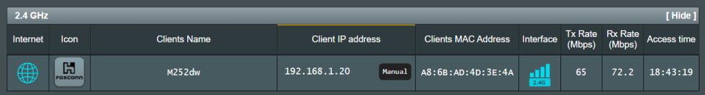

I have a new RT-AX55 and I have set up some bandwidth limitations for certain wireless devices in my network but when I look at the client list it seems that the transmit and receive rates still exceed the limits I set. What's wrong?
A Wi-Fi client's Tx and Rx rates are unrelated to QoS.
Are you sure?
I'm fully aware of how QoS works. My question was, are you asking about the Wi-Fi Tx and RX rates shown in my screen shot? Those have nothing to do with QoS. If it's not that then what are the "transmit and receive rates" you're referring to? Post a screen shot showing the problem occurring.
What's wrong?
One is bandwidth the other is link speeds. Bandwidth will be limited, link speeds will stay the same.
