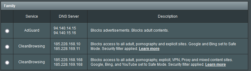

I want to block my internet from adult content instead of trying to block each individual device. I added my router as a client and so far so good.
There are DNS options in the WAN dns setting that may do this as well.
that bypasses the DNS servers right?
Actually, on stock Asuswrt anything with preset on-device DNS or using DoT, DoH, DoQ, etc. will bypass the WAN DNS servers.

No issues with it messing up my router but, it doesnt seem to block anything. bottom line. it doesnt work.
You can do it:
- switch to Asuswrt-Merlin firmware, your router is supported
- use ClearBrowsing DNS servers (or other similar) in WAN settings
- enable DNS Director with Router redirection in LAN settings
- install Diversion and use it for known DoH/VPN/Proxy blocking
- block in Firewall, Services Filter ports 80/UDP, 443/UDP, 853/UDP
- you can use Trend Micro engine Parental Controls on top per device
What you get:
- DNS interception and redirection on port 53 to your WAN DNS servers
- custom DNS servers (unrestricted) to specific devices on your LAN
- common avoidance techniques as popular VPN and Proxies blocked
- custom DNS on device, DoT, DoH, DoQ, iCloud Private Relay blocked
- not guaranteed to catch everything on your LAN*, but perhaps >95%
- you have to deal with what you block, it becomes subject of interest
* - all of the above is out if the devices have access to mobile data or other Wi-Fi networks (friends).
