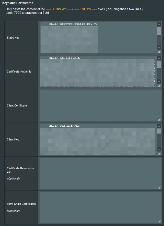

great thanks. can you click Edit on the client cert bit and let me know which fields are filled in?
