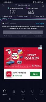

Hello everyone! In need help I am running 2 asus rog rapture gt-ax11000 on aimesh. I just switched to fiber.
Before I had cable internet and my speed test where 600 mbps download 28 mbps upload (caped).
So once I switched to the new fiber guaranteed 900 mbps download 700 mbps download I am only getting 180 mbps download and 700 mbps upload on wifi.
I have verified that I am getting what I am paying for.

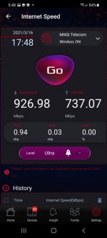

I did disable QOS and did an internet test using the asus app and I am getting 900 down 700 up but doing a speed test in my phone I keep getting this low 170 down 700 up.
It's almost like the download is being caped. When I do speed test it wants to climb high but it stops at 300 mbps and then drops to 190mbps.
I have being back and forth with asus and they still don't know what's going on.
Anyone please help!

So I enable QOS and filled in the boxes and my internet connection and wifi are even lower. Using the speed test under QOS I was getting 900 download 700 upload now after enabling QOS I am getting 500 down 600 up and doing a test on my phone got 140 mbps download 575 mbps upload.
As you can see something is very weird about this.

Try running some iperf tests between the phone and a computer wired to the router. You can download "Magic iPerf" in the phone and download and decompress iPerf3 on the computer.
On the computer open a cmd windows, go to the installation folder and run iperf3 -s (server mode). On the phone use these options on Magic iPerf: -c <ip of the PC> -t 60 -P 10. Then do a reverse test using these options on the phone: -c <ip of the PC> -t 60 -P 10 -R. These tests will tell you the wi-fi speed that you can get from the phone to the router on each direction
