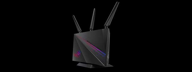

Are they both same routers SOC and antenna wise?
I believe so, but greater minds than mine will be more informed. This review seems to confirm it though:
There is no Merlin for the GT-AC2900, which is worth knowing. I did wonder, since they are on the same chipset, what would happen if I flashed Merlin for RT-AC86U on the GT-AC2900 but:
