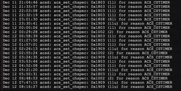

GT AX11000 PRO, never had issues with wifi and a few days with 388.5 noticing random slowness ... something's odd with this firmware.
Going back to reliable 388.4. Adding log section with messaging never saw before, perhaps that's the issue.

Hi team, any idea why this is happening?
it used to be in the same status with 388.4 as well. Not a big issue, just if anybody knows why.

What have you tried in remedy?
