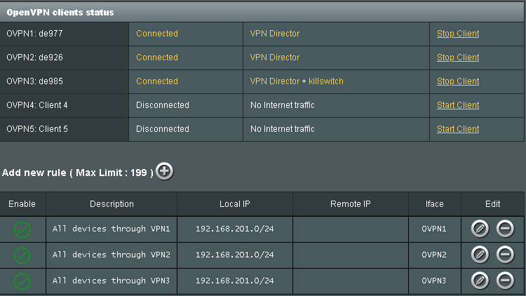

Quick question: My goal is to have some redundancy on my VPN - if VPN-Server 1 goes down, the system will switch to VPN2, then VPN3. If all three servers are not reachable, the kill switch is supposed to kick in. My current setup is seen below. My questions would be, and any help is much appreciated:
1) Would these setting alow me the desired VPN redundancy?
2) Would VPN2 and VPN3 need to be set to ON? Or could I leave them OFF ("Stop Client"), and the router would switch them ON automatically if VPN1 goes down and it is looking to enforce policy rule no 2?
3) If they have to be switched ON for the redundant setup to work: Are the constantly connected to the VPN (as the status is "Connected")? My VPN provider only allows six connected devices - so having three connections from my router would be a shame.
1) yes
2) yes
3) yes
It seem to be configured fine, but with the old firmwares with such setting, I could not excluse a device or website from the chain.
I want also to know why. I have just installed the firmware now. I have not tested anything yet.
BTW I see the kill switch is configured to the last active client only, it is well configurated!
