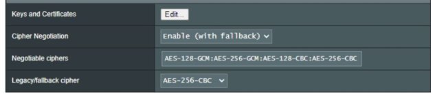

Can't connect to NORDvpn, after fallback from ASUS the latest firmware version 3.0.0.4.388.22238, back to Merlin 388.2 Alpha, but get the system Log:
ovpn-client1[8907]: --cipher is not set. Previous OpenVPN version defaulted to BF-CBC as fallback when cipher negotiation failed in this case. If you need this fallback please add '--data-ciphers-fallback BF-CBC' to your configuration and/or add BF-CBC to --data-ciphers.
Feb 10 13:19:11 ovpn-client1[8907]: Options error: You must define CA file (--ca) or CA path (--capath)
Feb 10 13:19:11 ovpn-client1[8907]: Use --help for more information.
Feb 10 13:19:11 openvpn: Starting OpenVPN client 1 failed!
Since there is no such setting in Merlin firmware , such as Cipher Negotation and Legacy/fallback cipher,
will there be any one here can help me to solve this problem.
or can I fill in something in the attached fields ?
