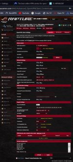

Can't connect to NORDvpn, after fallback from ASUS the latest firmware version 3.0.0.4.388.22238, back to Merlin 388.2 Alpha, but get the system Log:
ovpn-client1[8907]: --cipher is not set. Previous OpenVPN version defaulted to BF-CBC as fallback when cipher negotiation failed in this case. If you need this fallback please add '--data-ciphers-fallback BF-CBC' to your configuration and/or add BF-CBC to --data-ciphers.
Feb 10 13:19:11 ovpn-client1[8907]: Options error: You must define CA file (--ca) or CA path (--capath)
Feb 10 13:19:11 ovpn-client1[8907]: Use --help for more information.
Feb 10 13:19:11 openvpn: Starting OpenVPN client 1 failed!
Since there is no such setting in Merlin firmware , such as Cipher Negotation and Legacy/fallback cipher,
will there be any one here can help me to solve this problem.
or can I fill in something in the attached fields ?
Asus GT-AXE11000 @388.2 Alpha
The cipher line is just a warning indicating that you might have issues if your remote end is running a very old version (older than 2.4). Your actual problem lies with the missing Certificate Authority certificate.
Sorry RMerlin, I am just a layman only, I just don't know how to insert back the missing Certificate Authority certificate, here is my VPN client input screen. Pls help me how to insert back the missing Certificate Authority certificate. I tried to contact Nordvpn but they just said only have a guide for Asus Rapture routers when they have VPN Fusion option.

Upload the NordVPN ovpn file and configure the client again.
I tried to upload the related ovpn file and get the same result error-check configuration! and I had contacted NordVPN several times, they just said there is nothing wrong, but they just support Asus's VPN fusion only,
weird, cause i use nord/udp on my ax86u and it's fine. you may have to post your config for more help. oops, are you on 388.2? i missed that. shouldn't you be on a different thread?
I had already upload my VPN Client input screen above.
388.2 alpha is an unsupported alpha release for people that want to experiment with it. Go back to 388.1 and see if the same problem exists.
I tried fallback to 388.1, still get the same result
Check the VPN client "Keys and Certificates" (Static Key and Certificate Authority). They are part of the config file you downloaded from NordVPN but were missing in your post #825.
sorry, how to check ? I just a layman, I only know how to follow the instruction step by step only. As I had already contact NordVPN and they just said it seems normal in my VPN client setting
Don't forget to press tjhe "Apply" button after uploading the ovpn file you got from NordVPN. And do it againg after doing any changes, like entering your username and password.

I do press the Apply button in order to make the change, but the result are the same
Been running 388.1 on my 3 routers with Torguard VPN, no problems since released. And I've been using Merlin for many years now.
My router works fine before I installed Asus latest Firmware version 3.0.0.4.388.22238, it slow down and have a poor response time, so I fallback to the 388.2 Alpha 1, and restore all data will my backup, then the VPN showed error, I then initialize all the settings and reinstall 388.1, but get the same result. Will then be any expert on this area can help me here.
Thank RMerlin, finally self-learned from this site :https://www.vpnuniversity.com/routers/how-to-setup-openvpn-asuswrt-merlin, to manually import the CA certificate back in the Crypto Setting, the VPN client works again.
