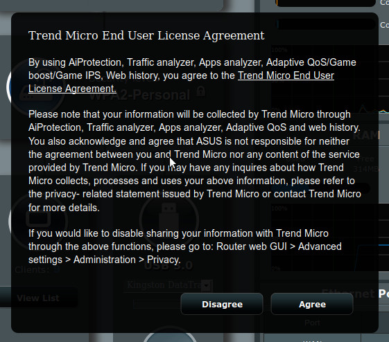

Router: RT-AC88U
Firmware: Was: 384.5 , Now: 384.6_beta1
Upload and reboot went ok. But once logged in, I get this popup:

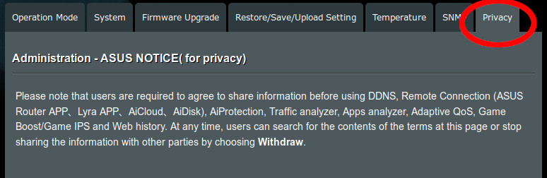

Also I now see a new tab in 'Administration' labelled 'Privacy':
I have been using 'Adaptive QOS' w/ the 'FreshJR_QOS' and 'FreshJR_QOS_fakeTC' scripts for a while now in 384.x firmware, but I've never had to 'Agree' to this EULA before in order to use QOS. And clicking 'Disagree' disables QOS. Is this expected behavior now, i.e., 'Agree' to Trend Micro's EULA, or Adaptive QOS will not work?
Other than this EULA issue, and the fact that QOS was not working, all was well for the next 12+ hours.
Then I rebooted.

Adaptive QoS has always used the Trend Micro DPI engine, and therefore was subject to their EULA. The only change is that the EULA is shown again with updated language on first time you log in following the update, with the new added option of opting out of an already accepted EULA.
This change comes from upstream, not from me.
I swears, I've never encountered the TM EULA before, thus my surprise (and confusion) at it's appearence in this RT-AC88U_384.6_beta1. Thank you for the clarification.
