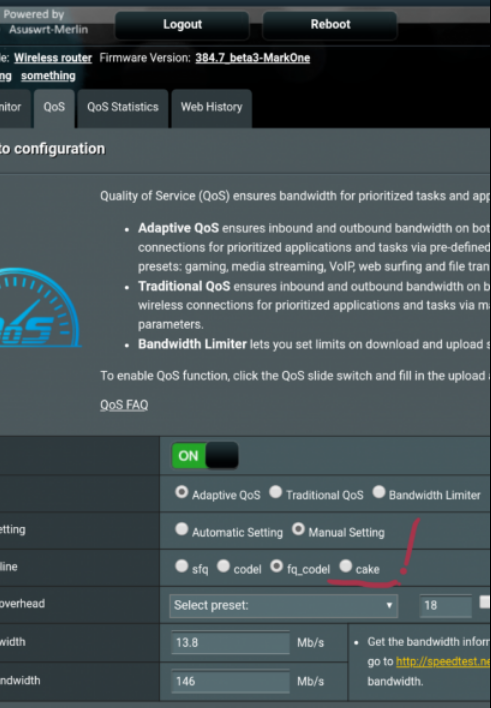

I was looking at the SQM screens in my OpenWRT installation on Raspberry Pi. It's quite dull, but could be done.

@dave14305....maybe you can bring some of that Flex magic to Cake!!!! ;)
Hi I am game for your thoughts/input. I can get an Enhancement/Issue opened and thus the collab between @Adamm and co. Thanks for the quick reply.

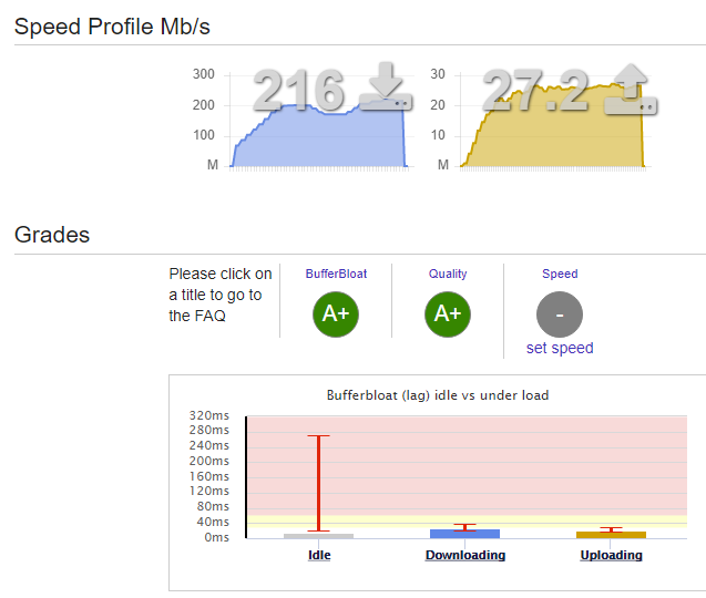

What is the relationship between the RTT commands and buffer bloat? I've experimented with different values and setting the RTT to a lower value negatively impacts the bandwidth.
Somebody suggested the RTT should be set to match the first hop ping to my ISP:
traceroute to virginmedia.com (213.105.9.24), 30 hops max, 38 byte packets
1 10.53.35.89 (10.53.35.89) 8.958 ms 11.531 ms 10.845 ms
2 croy-core-2a-xe-700-0.network.virginmedia.net (62.252.14.33) 9.940 ms 12.8
This reduces my download speed from 380Mbps to 216Mbps. This online test claims that my result is A+, but the buffer bloat is 280ms?
Are there any benefits to reducing the RTT in Cake QoS?
No matter what settings I'm trying, I still seem to be suffering from some buffer bloat and some quite large spikes in buffer bloat - e.g. jumps from 6ms to 300 ms during the test.
My main reason for wanting a working QoS solution is online gaming. I'm after a low and stable ping with no discernible spikes - i.e. I see on my screen, what is actually happening in the game. It is also important that when I click fire, the other person dies. I'm willing to sacrifice a bit of bandwidth to achieve this, but I'm struggling to see any improvements.
You do not have a buffer bloat problem as your scores are all A and/or A+
