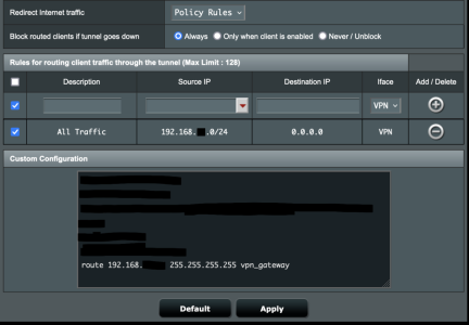

Can any tell me why this is not working?
AsusRouterUser
Can any one tell me why the route is not working, if I set "redirect internet traffic" to all then it works, but not with Policy Rules?

Post your screenshot again without the IP information blanked out. There is no reason to hide private IP addresses, it just makes problems more difficult to diagnose.
Look in the system log for error messages when you start the VPN client.
You appear to be using an old version of the firmware. Policy Rules was replaced by VPN Director some time ago.

Sorry I am not where I can take another screenshot, however the missing parts are at the top the All Traffic is 192.168.50.0/24 and the part at the bottom is route 192.168.25.100 255.255.255.255 vpn_gateway and that is a local machine on the other side of the VPN, I can get to it no problem with All instead of Policy Rules, but with it set that way if the VPN goes down it uses my regular internet instead of just thinking there is NO internet like it does with Policy Rules (which is what I want). As for it being old firmware it is because it is an old router and that is the newest firmware I can get for it. I only use it for temp stuff most the time it is off.

Sorry I was not clear the issue is I can't get to the routed device ie 192.168.25.100 when it is set to Policy Rules but I can get to it if, it is set to All, and I want to use Policy Rules, but I can't figure out why the "route 192.168.25.100 255.255.255.255 vpn_gateway" does not work when it is set to Policy Rules. Sorry and it is "Redirect Internet traffic".

Can you confirm that 192.168.25.0/24 is the network on the server side of the tunnel? Is there any unusual routing happening on the remote network?

Yes 192.168.25.0/24 is definitely the server side of the tunnel and no there is nothing unusual happening on it.
