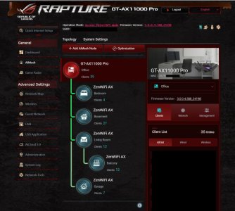

I originally had a 6 nodes AiMesh network (AP mode, 1 main XT8 and 5 XT8 nodes, mixed wired and wireless backhaul).
Tired of backhaul instability regardless of any firmware version, about 6 months ago I replaced the XT8 main node with a GT-AX11000 Pro.
Since then all backhauls are stable and always reported as Great, never rebooted any of the nodes till today!!:)
Hm...so you replaced the main node.
Problem I'm seeing from that picture is that router lacks some of the stuff I use on my XT8, particularly the VPN server, unless it's stored somewhere else.
This router has VPN client/server and can do about 4x faster VPN than your XT8.
As I'm using the AiMesh in AP mode, no VPN settings are available on the main node.
