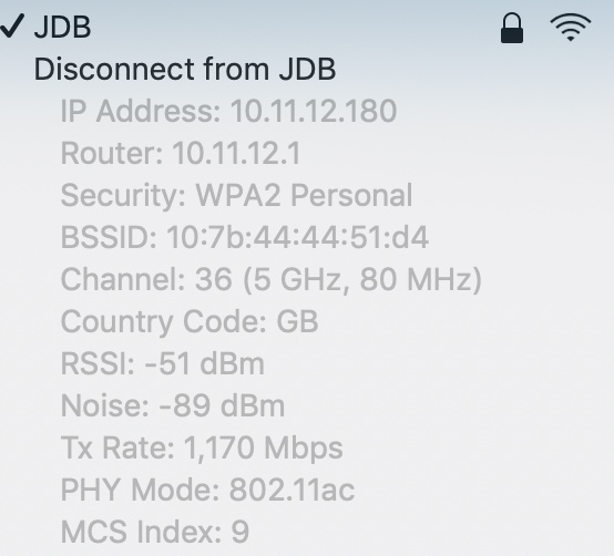

So right now I’m ~25ft from the router and getting 1170Mbps. If I move within 20ft I can get 1300.

I see a tx rate of 1,300 Mbps in MacOS's wi-fi menu but I assumed that was the max speed possible; not the actual current speed.

There is the client WiFi connection link rate speed, and then there is speed test/throughput speed. Your bottleneck is most likely the 68U router. The 86U is a newer/faster router/CPU that supports speed tests of ~800 Mbps (don't quote me) but not full Gigabit ISP speed.
