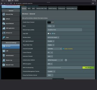

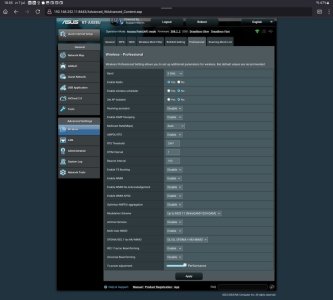

These are my settings on the AX88U and these work. Do you own only Apple devices?
