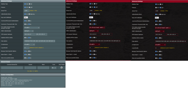

Managed to configure it and it works well between 3 sites, two and a main hub that the two connect to.
In case someone could use it going forward:
I got three sites, which I configured as:
192.168.111.1 - the main one, which acts as the VPN server the clients connect to
192.168.112.1 - Site2
192.168.211.1 - Site3
I attached a screenshot of the configuration of the three sites (from left to right - main, site 2, site 3), along with the VPN profile for the main site which the clients should use to connect to.
