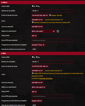

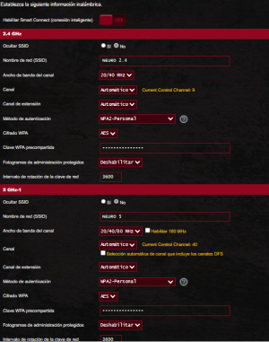

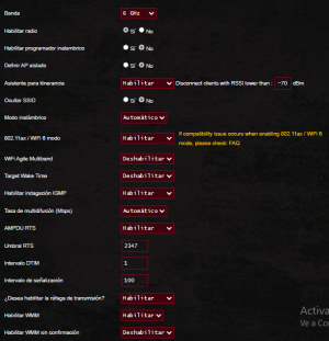

It may help if you post readable screenshots your WiFi settings (both General and Professional pages) with sensitive information (SSID and password) blocked out so others can see exactly what settings you have configured on your router. It may also help to do the same with the iPhone WiFi settings again with sensitive settings blacked out.

Could it be note 8 in this firmware release?
