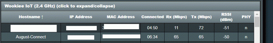

I would like to update the hostnames that are being used. I could be wrong but it seems Yazfi uses it;'s own hostnames list and updating the names after doesn't seem to matter even if you uninstall Yazfi with data removal.
It shows names that I had previously but I have since updated the names and they don't show the new names.
I uninstalled Yazfi and re-installed many times but it still shows the old names.
I can get it to display the devices connected but just wanted to update the list with the new names I made.
I will show you a pic. So for this device I disabled Yazfil. Had the device show back up in the Networking map and renamed the device from August-Connect to August_Connect, but as you can see it shows as August-Connect in Yazfi no matter what I do.
Showing Old Name
Once I disable Yazfi and have device show up in Networking Map you can see the new name again.
Showing Old Name
YazFi doesn't read names from network map, it reads them from a reverse lookup of the IP. You need to ensure the hostname is as desired on the device itself and/or on the LAN DHCP Server page.
