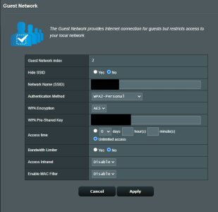

All my devices are connected to Guest Network (which has a different SSID than Main Network). That Guest Network uses 2.4 GHz. I have tried both "Enable" and "Disable" in the "Access Intranet" Option which made no difference. Time Remaining is "Unlimited access." I have also tried Disabling Roaming Assistant for the 2.4 GHz band.

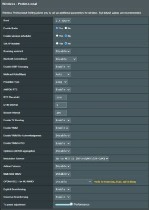

It may help if you post your 2.4Ghz WiFi settings, both General and Professional pages (redacting any sensitive information) in case others see a settings issue.

  • All smart home devices are connected to Guest Network #2 (which has a different SSID than Main Network). That Guest Network uses 2.4 GHz. Automatic DHCP IPs.
  • Security level is both WPA2-Personal for Main and Guest Network (different keys).
  • Time remaining is "Unlimited Access."

I would suspect WiFi settings first before hardware... try tweaking the 2.4 WLAN... fix 20MHz bandwidth to be courteous and to stop the router from switching between 20 and 40 to avoid interference (if happening, can upset clients)... fix the control channel to the one channel that appears to work best... test them all. And disable Universal Beamforming... proprietary and could upset the odd client.
Beware nearby USB3.0 devices generating EMI in the 2.4 band... and similar EMI culprits like cordless peripheral devices and microwave ovens. This interference can upset 2.4 client connections.

As already suggested, could be an issue with your WiFi settings.
It sometimes helps to choose a specific WiFi channel rather than leave it set to auto.
Just to add, I suggest lifting "Group Key Rotation Interval" to 86400 (24 hrs).
