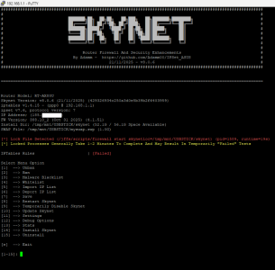

Is that a normal behaviour, that after every reboot, Skynet detects a lock file?
Nov 26 04:13:46 Skynet: [✘] Lock File Detected (/jffs/scripts/firewall start skynetloc=/tmp/mnt/USBSTICK/skynet) (pid=2410, runtime=3s) - Exiting
