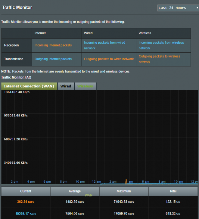

On alpha 2. There's sth wrong about the scaling of the chart of 24hr traffic monitor. It just scales up for no reason. The ceiling value is now 1361462.40KB/s, rendering it useless. After restart the 'rstats', it starts normally, but gradually increases the ceiling indefinitely.
Didn't experience it on alpha 1.
2020-03-15_12.24.31.249_chrome_ASUS_Wireless_Router_RT-AX88U_-_Traffic_Monitor__.png 2020-03-15_12.53.28.722_chrome_ASUS_Wireless_Router_RT-AX88U_-_Traffic_Monitor__.png
View attachment 21925 View attachment 21926
