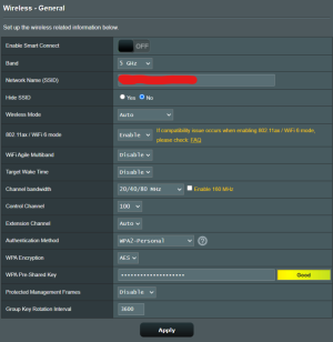

Thanks for your reply! But I already have a fixed 5 GHz channel, or do you see something else?

Then there appears to be something messed up in your nvram settings (or it's a bug in the firmware). ACSD shouldn't be running on eth7/5GHz with a fixed channel. I've just tried exactly the same settings as you on my router and the acsd process isn't running at all (because I'm also using a fixed channel and bandwidth on 2.4GHz).
Have you tried a factory reset? Did you import any old settings from a previous router?
Do you have any AiMesh nodes configured?
