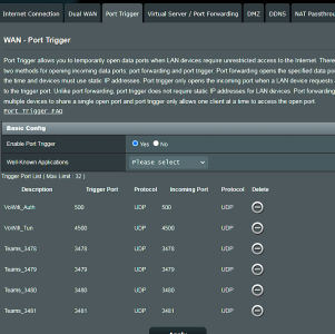

I have a newly bought RT-AX86U Pro and faced reboot loop for every 10-15 minutes.
I used to think it was related to the massive outage event of ASUS earlier.
I even went to claim for another hardware from ASUS store, but the problem still persist.
I also tried different firmware versions, but doesn't help
Turns out if I turn off the Port Trigger feature, the reboot loop stops.
I did not have this issue on AX86S.
Does anyone also face this issue?

Why do you have port trigger turned on? It's off by default. I see Teams and what looks like wifi calling, not sure you need port trigger for those.

I am using wifi call on my cell phones as my house not receiving good signal for calling. If not having 500 & 4500 UDP enabled, incoming calls always failed for the first time.
For the teams, that's optional to me. I can just remove it for simple.
I have been tried for 3.0.0.4_388.23565, 3.0.0.4.388.23285, 3.0.0.4.388.21070, all results are the same.
May be I try remove the teams port first

I have the same scenario - not good enough mobile coverage, yet I don't have the problem with phones establishing ipsec tunnels to operator and keeping it alive. I can see most times wifi calling taking place, both inbound and outbound.
But no port forwarding needed. Because phone is the one initiating the tunnel and keeping the tunnel alive.

Thanks for the opinion.
That's a nice feature to solve my incoming wifi call problem.
But if it is problematic, I could disable that.
Just spent me so much time to figure out this feature causing the crash. It drives me crazy
