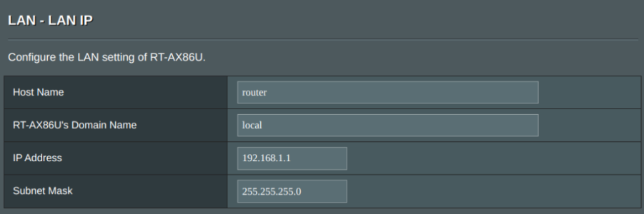

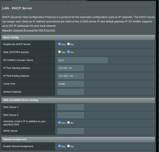

I want to use host names instead of IP addresses. From what I learned about this, I configured like these:
Screenshot from 2023-06-03 13-59-30.pngScreenshot from 2023-06-03 13-59-10.png

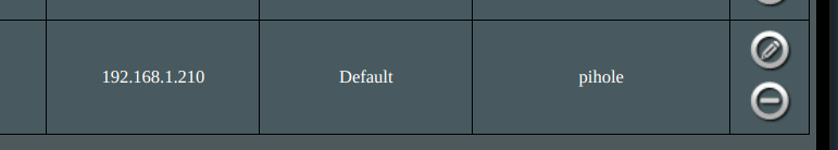

I access to router's UI using "router.local" just fine. I assigned "192.168.1.210" with "pihole.local" but it does not work.

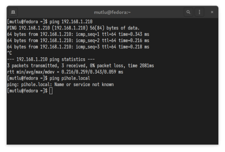

I did not change anything on my client network configuration. DNS is set to auto. In fact, I can't access pihole.local from any other device either.
Note that I can access router with router.local just fine. If something would wrong with the DNS config, shouldn't I also can't access it there?

The reason you can access router.local is likely because your client is using mDNS (which is running on the router) to resolve the name instead of DNS. It's for exactly this reason I suggest not using .local for DNS, it just leads to confusion.

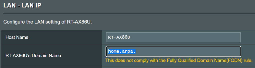

try: home.arpa
That's not the point though. According to the RFC Dave posted the reserved domain is home.arpa. not home.arpa It's meant to replace .home
EDIT: I'd guess it'd work on the grounds that trailing dots are ignored/presumed anyway.
