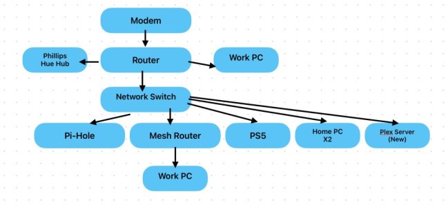

Attached a picture, I feel like I have a simple setup. Since I started experiencing these problems I have a completely new Raspberry Pi with a completely new image and install of Pi-Hole. I’ve run some new cables from the Router to the Network Switch (previously was a flat cable that looked like it may have had a small frayed piece. The PS5 and the Plex Server are new to my setup. Additionally my personal PCs are usually powered down, unless playing games on them. I’m not looking for anything special, I’m just looking for everything to work.
Someone previously had mentioned that it appeared like something on my network was basically DDOS’ing my router and then it shuts down the Ethernet. I wouldn’t even know where to start. I assume it has to be an Ethernet device.

What type of switch are you using?
Does plugging the Pi-Hole directly into the router help?
Does unplugging the Hue Hub help?
Have you checked that the Ethernet cables used are good (by testing with new/others)?
Network switch is about 6 months old, DLink 8 Port unmanaged gigabit. I tested just unplugging most of the items off the network switch (except the pi hole, mesh router). Didn’t seem to change anything. I’ve always suspected the Hue Hub is the issue. I’ve swapped cables for it, and whitelisted Phillips domains just in case it is freaking out because it can’t phone home but to no avail. I have an extra Pi I was thinking about running home assistant on to remove the Hue hub from the equation.

I can't decide if I would start by swapping out the Hue as you suggested or if I would swap in a different switch first.

Hue Hub is relatively new, I got a new one a while back when problems started surfacing. Work PC is a wired connection, which is connected to the Mesh router which is wired to the switch back to the router. Other work PC was wired to the router. Tried to ping but it’s all VPN so it didn’t work.
No animals or other potential things that would move connectors. Switch it out of the way from people being able to mess with it.

As of the other day I noticed that the app is saying I have a slower wired connection to my mesh router, not a gigabit connection. I tried a reboot of the router but no change. The port on the router shows a gigabit connection to the Ethernet switch. But apparently that connection from the Ethernet switch to the mesh router is slowed down to 100mbps. Would something else on the switch be slowing it down? Or is it just likely the switch is messed up?
I have not had issues with the Raspberry Pi (pi hole) since connected directly to the router. Same with the Hue hub, which was left connected to the router.
Confirm an alternate port on the switch functions correctly by other means first, then swap the feed to the node to that port and see if the trouble follows. If it does it's most likely the cable or one of its connectors.
Ok, switched the node from port 3 to 2. Checked and now connection is great. Went ahead and moved the feed over to 3, no change as of yet.
