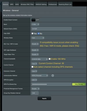

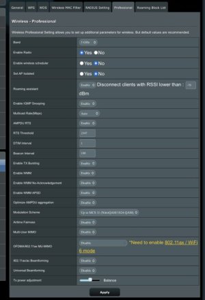

Good day. I could use some feedback on 5g settings. I’ve never really used it before due to amount of walls in the place but I got a new AX86u so may as well use it. I’m mainly looking for compatibility, stability, reliability.
This is what I have currently, basically defaults. Location North America.

Enable AX beamforming (not universal). You can leave the TX power at max, granted your clients may not have enough power to get back to the router at extended distances but that is what the roaming assistant can help with. I can't see what you have it set to, I think -70 which is usually good, if you want it to be more aggressive at disconnecting clients try -60.
I usually disable TX bursting as that is only supported by certain wifi clients and there are some that it can cause problems with (though that is probably mostly resolved recently). Still, it is fairly useless.
You can try enabling MU-MIMO, most find it doesn't do much, but it also typically doesn't hurt anything. It theoretically can help when you have more than 1 client using a lot of bandwidth.
You can enable AX/Wifi 6 - if you don't have any AX devices it shouldn't hurt and if you do it will give them better throughput and make more bandwidth available.
Rest looks ok to me.
I use the default settings except for setting 2.4 GHz to 20 MHz, disabling WPS and using DFS channels.

Location and router version the same as yours - Canada. Use channels 149-161 in Canada - up to 1W allowed.

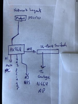

Thanks for the help. I’ve read to leave spanning tree enabled with my setup. I’ve also read about starting ip range at .9 so there is a few spare addresses for static ips, however the printer and nas and AP point seem to keep static on their own.
Here is a free hand on a small envelope….I think I should get a ruler. Also I have traditionally used open dns and been happy with it. Just wondering if anyone uses CIRA? I think merlin said at one time it was good?
This is someone's personal view on things. You can have your static IPs inside DHCP range in Asuswrt. You can reserve IPs for your devices if you want to. This router can take 128 reservations with no NVRAM issues. Save/restore methods exist for both Asuswrt and Asuswrt-Merlin.
