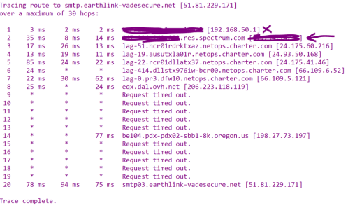

My OpenVPN servers on two different GTAX6000 are both allowing internet access when configured for LAN only. Toggled the values back and forth but no change. These VPNs are for my admin access only and in the past if I forgot and tried to google something it would be clear-no internet access. Is that setting/value saved in a file or nvram value? This happens on both iPhone and windows laptop. I guess my first step is to restore 1 rev using backupmon. Is anyone seeing the same behaviour??

1st scratched line is the address of MY router and not the router I am VPN'ed into. So its still going out my gate and not thru the tunnel. I have a different issue here from what I thought. Why isn't all traffic going thru the tunnel?
If you want all traffic from the client going through the tunnel you need to set the server option to "Both". Bear in mind that if you're using VPN Director on the client side that will take precedence.

With LAN only, openvpn doesn't change the default gateway when a connection is made. The client accesses the internet through its own default gateway, resulting in split-tunneling. It has always been like this, the memory of man runneth not to the contrary.
I suppose if you only want to reach the server's GUI, you could edit the client configuration to insert a pull-filter ignore instruction to ignore the route.
