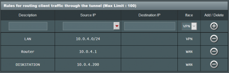

Thanks Guys - some things to think about then. I have done some testing, by tethering my mobile phone and using it's own Internet connection to make sure everything works, but I'll run more tests closer to the travel date. This is how I currently have the Client VPN configured on the RT-AX88U:
