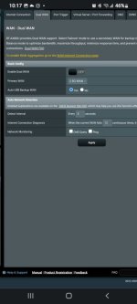

Edit: I changed the view from image to list and it explains better what I was seeing. It's saying 2.5g is unplugged but it seems it as 2.5g LAN port. In list view it shows the Primary WAN as 2.5g. It is a little misleading as it looked like I wasn't using the 2.5g port.

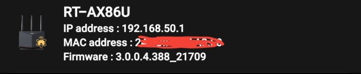

My AX86u is setup so the 2.5g port is used for the Primary WAN. In the web portal it's showing the 2.5g port as disconnected and the regular WAN port as connected.
Any ideas? I'm in the latest firmware which I upgraded today (screenshot). The issue was also present in the last patch. I only have 2 devices connected to the router. My AppleTV, my alarm system hub and my Modem plugged into the 2.5g port. The Alarm system is the one in yellow throwing a warning. I think because it only has a 10/100 nic.
I have internet and have been using the 2.5g port for quiet some time. I never noticed in the web portal that it was saying unplugged. I only noticed it today because I'm on a 2gig internet connection but my ISP didn't have any cable modem in stock that supported those speed. I finally got the new modem.

"My AX86u is setup so the 2.5g port is used for the Primary LAN. In the web portal it's showing the 2.5g port as disconnected and the regular LAN port as connected."..My AX86u is setup so the 2.5g port is used for the Primary LAN. In the web portal it's showing the 2.5g port as disconnected and the regular LAN port as connected.."
I think you have typo in your problem statement.. you're using the 2.5 port as the WAN and the GUI cant seem to show it well?
From your speed tests it sounds like you're breaking the 1Gbit barrier and your internet is working.. Maybe try a different high quality Cat6 cable between the modem and router? But it sounds like a bug firmware or a weird conceptual point of view from the writers?

Firmware bug in latest and previous 388 release.

Ahhh yes there was a typo. Thank you. I'm using a Cat6E cable I bought just for this.
I am breaking the 1gig which leads me to believe it is working as I wasn't able to break that barrier before.
The photos make more sense as the webgui sees the 2.5g port as separate ports. Its either a lan or wan.
It looks like I was just confused and I couldn't put a support ticket in because my warranty just expired last month lol.
I appreciate the sanity check.
Thank you for this. This was exactly it. Much appreciated. It's been awhile since I been on the forums, I really should keep up with that update thread lol.
