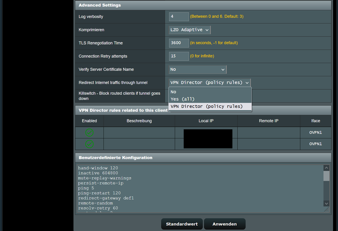

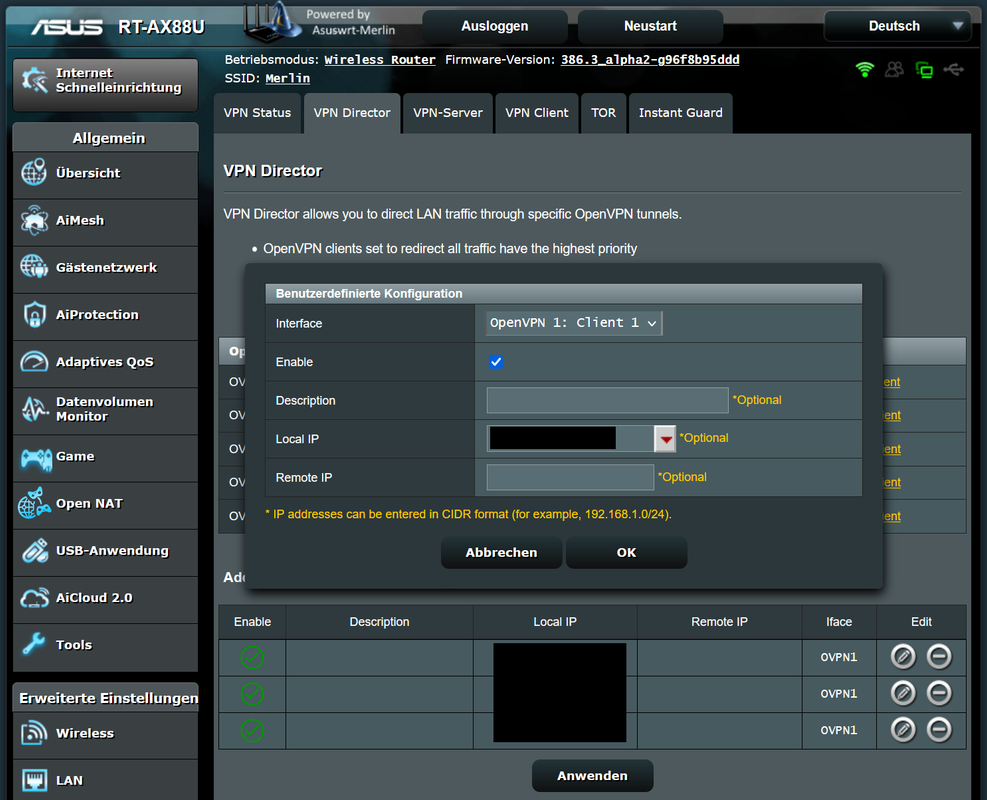

keeping or switching back to the old (RT-AX88U_386.2_6).
had in the alpha dns leaks (vpn drirector), the only config without dns leak was:
with "all" over VPN had a dns leak.
because wan first then vpn.
with vpn director you have no dns leak, but on the other side the other traffic is send over wan not vpn (totaly unsecure in my eyes).
