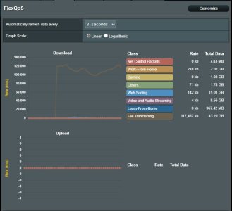

Not sure if this is a known issue or not, but since updating to 388.2_2 on my RT-AX88U FlexQoS no longer displays correctly on the upload section (see attached). This issue was not present on 388.2.
It's potentially an issue with QoS itself I suppose as the Classification tab is also messed up in a similar manner.

Definitely a firmware issue in 388.2_2.
Out of curiosity, please run these commands and post the output here:
cat /sys/module/tdts_udb/parameters/dev_wan
cat /sys/module/tdts_udb/parameters/qos_wan
