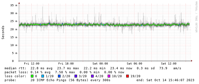

And with DOCSIS 3.1, Jitter isn't that big of a deal, it's very constant over time
see below - constant PING to google...
