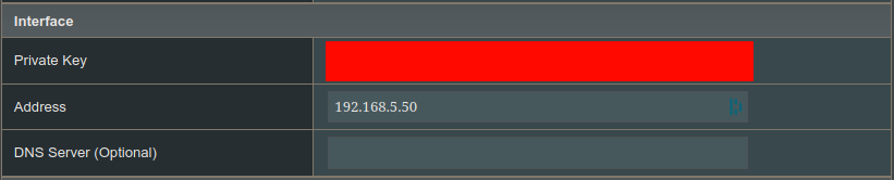

I was looking through ip a and ip route, and realized that the problem was in the default subnet of the wireguard interface. In DD-WRT, this was my configuration:
The interface IP address is set to 192.168.5.2, and it explicitly asks for a subnet.
In ASUSwrt-Merlin, however:
There's no box for a subnet, and so if you don't specify one in CIDR notation, it assumes /32. However, I wanted /24. Here's the fix:
That's why the router couldn't find a route back to 192.168.5.1: it didn't know that addresses other than 1902.168.5.50 existed and were accessible on that interface. After the change, the ip route listing is there too:
