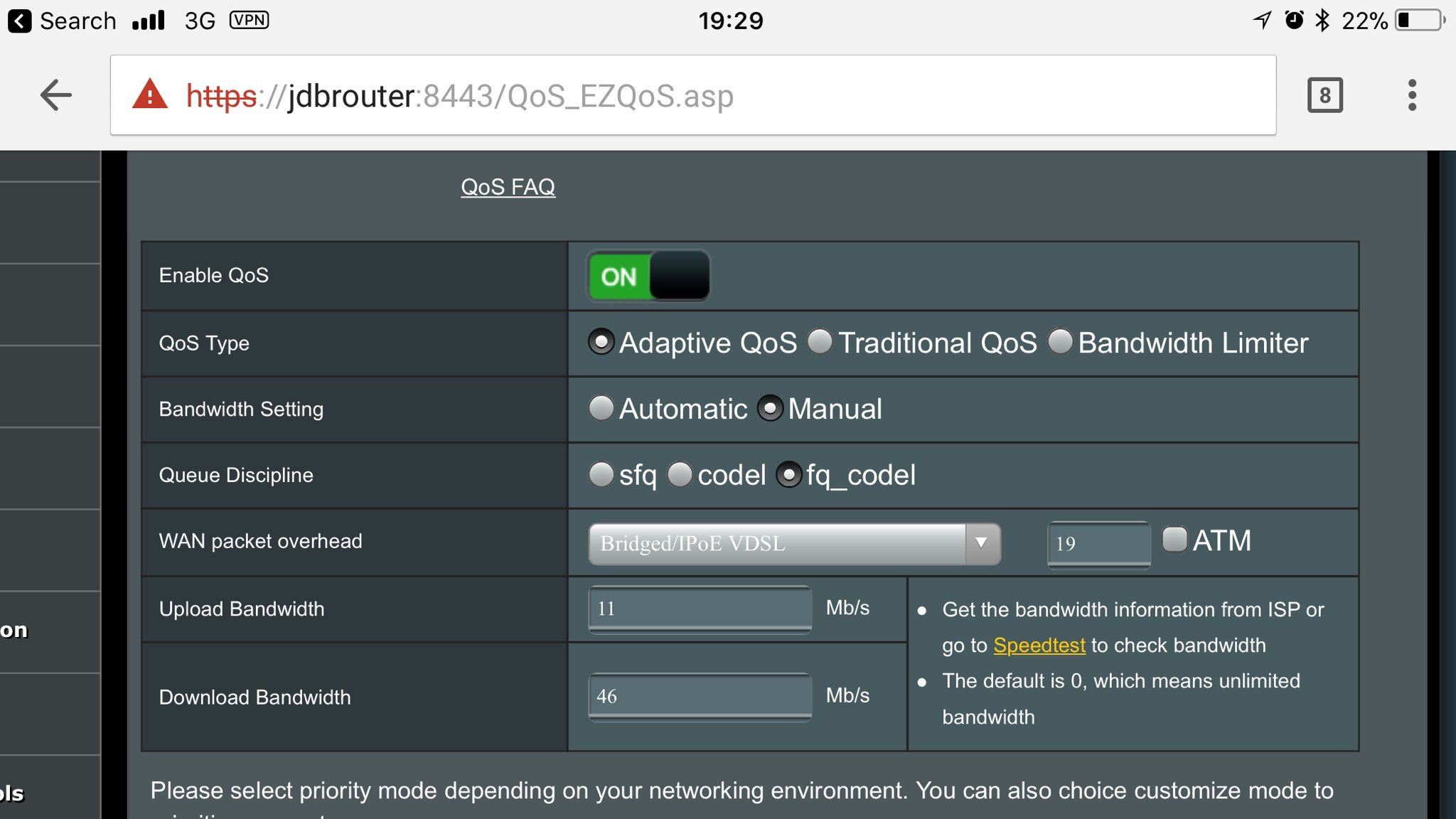

These are my settings. Of my 46Mb sync speed I can use about 44Mb with QoS on (and the full 46 with it off).

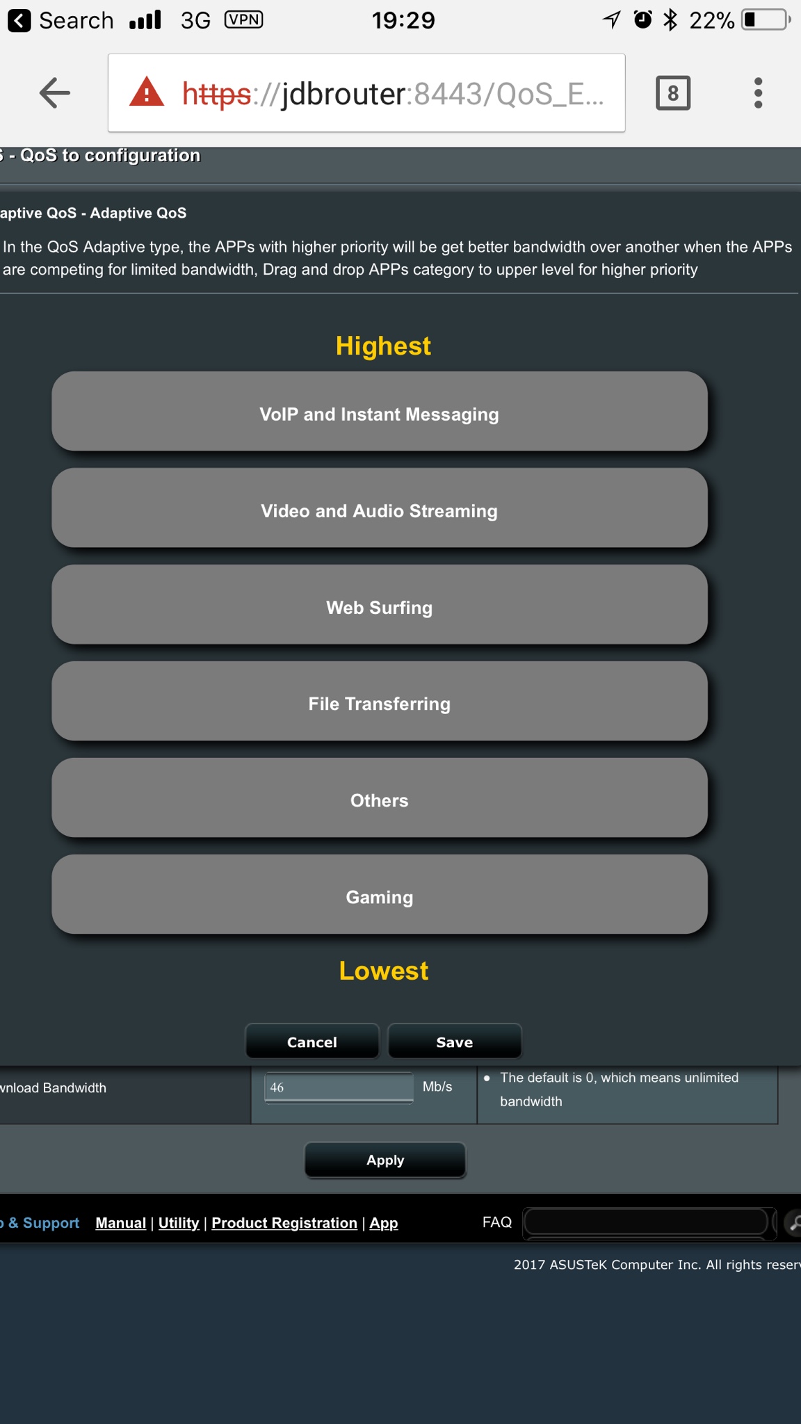

These work perfectly for me, obviously you can put gaming at the top for your needs!
