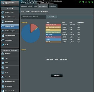

Nothing out of the ordinary there, unless I've mistakenly confused upload and download in my post - the issue you describe sound typical of the WAN interface used by Trend Micro being different than what returned by get_wan_ifname().
Hmm, I really don't know, all the versions of the DPI engine I used were always using the eth0 for the rules, so that sounds right.
That definitely wasn't the case with earlier 382 release from Asus. So they must have changed it back to the 380 behaviour.

Another hint I get from Chrome's console: from the ajax_gettcdata.asp requests I see the responses being like this:
var tcdata_lan_array = [
["11", "2212565", "0bit", "0pps"],
["10", "71746560", "872bit", "0pps"],
["13", "7547168", "0bit", "0pps"],
["12", "0", "0bit", "0pps"],
["15", "7222753", "2104bit", "1pps"],
["14", "451654957", "38528bit", "7pps"],
["17", "1870383", "344bit", "0pps"],
["16", "0", "0bit", "0pps"],
var tcdata_wan_array = [
So definitely it is not reading right the WAN interface stats.

Thanks. I will probably revert it back to hardcoded eth0, but just in case I sent an Email to the Asus engineer who works on QoS to see if he has a definitive answer (maybe there's a safe way to determine which WAN interface to use). I also asked at the same time about the random failure to setup QoS at boot time to see if it's a known issue, or something that's only broken on my side.

The first 382 version had the engine use ppp0 instead of eth0, which is why I switched to get_wan_ifname() in 382.1. Now if Asus reverted back to hardcoding it to eth0 for PPPoE, I might have to revert that change...
Anyone else with a PPPoE WAN that can confirm that their "tc qdisc" rules use eth0 and br0 rather than ppp0 and br0?
I think I have eth0 but I'm not familiar with what I'm doing. Try this https://pastebin.com/ZTk5LDm2
I also don't see the Upload stats
Another thing to note with QoS is that it can take up to a few minutes to be setup with the new Trend Micro engine (Asus even added a notice about it on the webui). Part of that is because the pattern file seem to take longer to get parsed to generate the app database, and also there are more rules generated in the traffic classifier, and Asus seems to avoid creating them in a big chunk, spacing creation a bit.
You could well be right here. It does seem that my QoS is taking a while to initialise and maybe I was running my first test too soon. I've doubled my patience setting and seem to be getting much more consistent results.
