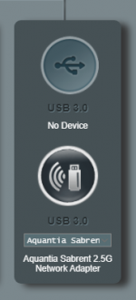

I know this is an old post but yes it works on the rear usb next to the WAN port only. It shows up as a modem in the config. All I did was unhook my cable modem, went to "WAN" tab then "Dual Wan" tab changed "Primary WAN" to USB and let the router do it's thing. Rebooted my cable modem plugged it into the adapter and then plugged it into the USB port. My internet runs at over 1 gig speeds now. Not sure I understand what you are trying to do but my Motorola cable modem wil run at over 1 gig (I have 1.2Gig Service) and it now shows it in speed test. I don't see how you would plug a PC into it and connect to the LAN though... doesn't seem possible. What you need is just to add fast wifi to your PC.

No but almost... There is no 2.5gb WAN port on the rt-ax88u which is a shortcoming if you have over 1 gig internet. So to get past that I am using a Motorola MB8611 cable modem plugged into a Sabrent NT-SS5G Ethernet to USB adapter and instead of the rj45 WAN port I'm using the USB port next to it on the back of the router for the WAN. I set the primary WAN port to USB under the Dual Wan tab and it automatically showed up as a modem port when I plugged it in, thinks it's an LTE Modem or Phone. I can now get over 1 gig internet speeds. My PC has an ac 9560 wireless adapter on board and connects at 1.7 gig so I can run speed test from there and get over 1.2 gig download speeds, I have 1.2 Gig service from Xfinity. The WAN port is no longer used unless I wanted to set it up for failover I guess. I just plugged things in to try it and it worked, did nothing special. It's been stable I've had no issues or slow downs I've noticed and now have a full speed internet connection.

Funny thing was I had to configure nothing except change it from the wan port to USB port. Disconnect the modem, change the wan port setting, plug the modem into the adapter, reboot the modem, plug it into the USB port and done. The adapter may show as 2.5gb because the modem connects to it at that speed. I'm pretty sure because the 88u thinks it's an LTE USB adapter it must not need a driver like it would for ethernet, it expects a modem and can see it through the adapter. Made me real happy to be able to get full bandwidth into the router, it cost enough and has performed well. Most everything I own connects to the WiFi at well over 1G... we'll see if Xfinity throttles me.

It needs a driver. The guy who added the driver and code before the latest updates to the kernel for the firmware used the USB adapter as a LAN port, not WAN. Plugged it in, hooked it up, 2.5gb port. BUT he added stuff to RMerlin’s code, scripts, compiling, etc.
