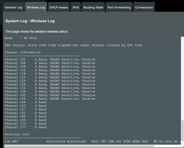

It would help if the users who are seeing this problem could identify which country they are in and what 5G channels are available to them. I am in the US and have not seen this issue on any XT8 release, however I do not use any of the Radar effected channels (which may not be an option for you). If you look at the wireless log when the issue happens you can see if a specific channel is effected by Radar or not. If Radar is detected then that channel (or channels) will be declared unusable for a period.

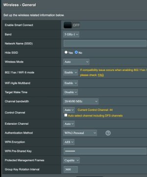

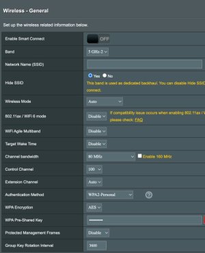

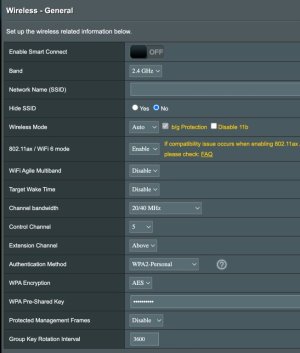

Country is Belgium:
Here are screenshots how my 5G etc is setup, It is not using Radar effected channels.
If you look at the wireless log when the issue happens you can see if a specific channel is effected.
I don't no how, because at the moment it is green.
I also don't know when it goes on orange, only when I check or walk in the room of the router and I see the led orange.

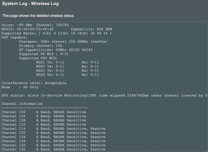

This is the screen that I would check when you have an issue. It shows whether a channel is Radar effected. (note... this is from a US system so it shows channels you probably don't have).Wireless Log.png
As L&LD said, all the channels available to you are Radar sensitive. 100-112 are currently active and cleared as not having Radar effecting them. The time tells you how long since those channels were cleared as "ok to use".
