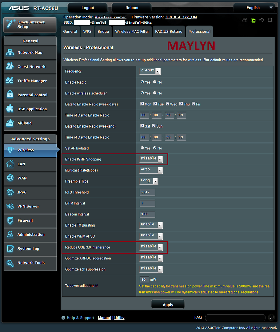

feeling "technologically challenged" but can't find the "advanced settings" in "wireless" (using the latest stable merlin build)
pls help
thanks
actually i don't seem to have the setting (this is where it should be...but it doesn't appear for me)
pls help
thanks
http://i146.photobucket.com/albums/...AC56U/ASUSRT-AC56U-3004372-24GHz.png~original
Sorry - it's called "Professional", not "Advanced". Poor translation from Asus IMHO, as I don't see anything "professional" in these settings.
