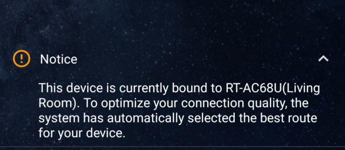

I have this same problem, and I'm looking for a "strict" binding of my son's tablet to my ground floor node. If he comes up, he's still able to connect to the 2F AP. I'd like him to be on the GF only.
Any solution to strict binding? Even if via script?

Tried this?
Wireless - Roaming Block List
You can add devices into roaming deny list, and the devices will not be roamed between AiMesh nodes.
