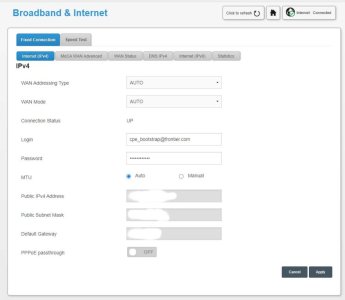

Just got a Frontier Fiber business account that has 5 static IPs. The tech wired it from ONT to in-house Sagemcom FAST5290 router using existing coax. I'm having a lot of trouble provisioning out the static IPs from there to my internal equipment. It seems like the IPs are not really provisioned thru to the Sagemcom although Frontier says they are. On top of it, I cannot find a manual for the FAST5290 anywhere, including Sagemcom's site.

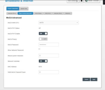

So question - can I replace the Sagemcom with an Actiontec Moca adapter and run the ethernet end to an OPNSense box? From there I'd try to set up my internal boxes that are to get these IPs. I know very little of what I'm doing with the OPNSense but unlike the Sagemcom router there is a ton of info out there for OPNSense (or pfSense). I see a couple of login type things in the Sagemcom setup that makes me think it would not be a direct replacement. For instance there is a login under IPv4 setup with cpe_bootstrap@frontier.com as the user and a password (starred out of course) as well as a MoCA Password under MoCa WAN advanced tab. Thinking both of these are likely critical for the current setup to talk to the ONT which a replacement adapter won't have.

I think I muddied things. In short, presently it's ONT(coax) -> coax cable in house -> (coax)Sagemcom router in office. From there the Sagemcom provides wifi and ethernet for a couple of computers that are wired. Would like to know if instead I can go ONT(coax) -> coax cable in house -> Actiontec MoCa device - ethernet. I'll then maybe repurpose the Sagemcom as wifi only or get some other wifi router. Does this sound proper? I posted setup pictures from the Sagecom that made me think this might not work. Thank you!
It'd have to be ONT -> coax -> MoCA -> some router -> the rest of your stuff. A MoCA adapter is just a bridge; it doesn't have any firewall or NAT ability, and you really must have both things at the front line of your internet connection. Whether the router has to be a Sagemcom or you can bring your own really depends on Frontier's terms of service (and whether they enforce them...)
